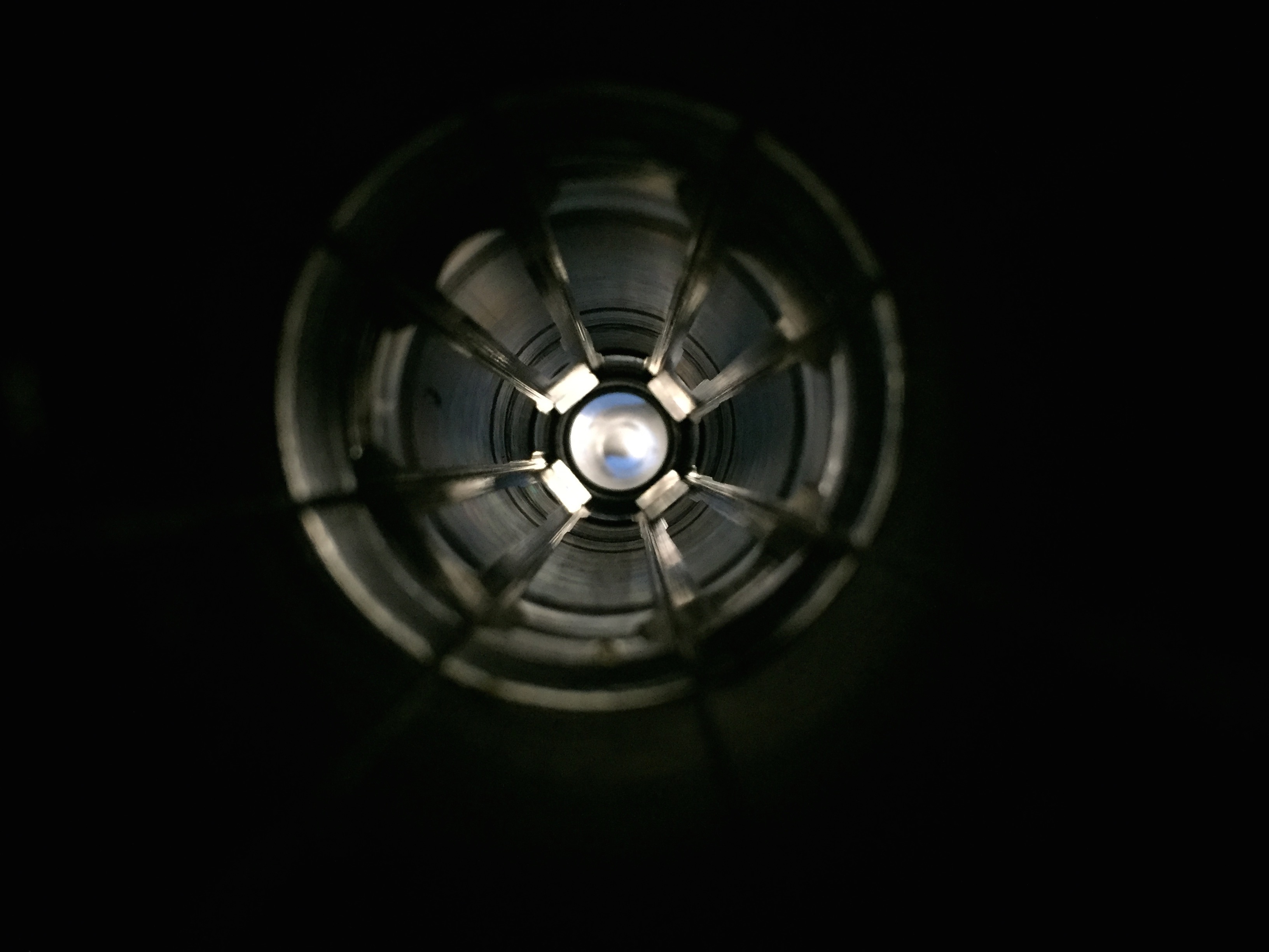

Rigid Lefty: View inside, the machined channels with the solid alu pieces fitted.
Rigid Lefty: Bonus! The collar fits too!
Rigid Lefty: fits like a glove.
Rigid Lefty: Keeping some adjustability for crown height!
Rigid Lefty: It will be a rigid unit, but still making sure to have some sort of adjustment for crown hight!
Rigid Lefty: Replacing the races with solid pieces of aluminium, to prevent rotation.
Rigid Lefty: Test fitting the solid race replacements.
