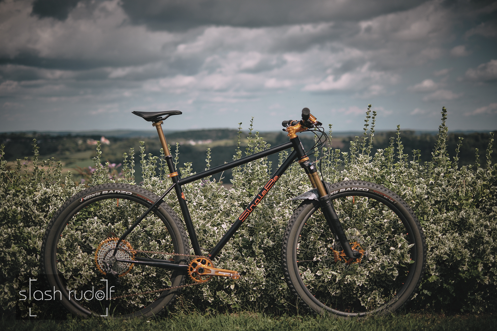

frame - SingleBe
wheelset - rims: carbon, hubs: DT SWISS 240, valves: Peaty’s x Chris King MK2
drivetrain: XTR - derailleur+shifter
chain: SRAM XX1
brakes: Hope XCR Pro E4
fork: Fox 34 factory SC - 120mm
handlebar: Hope carbon 800mm
dropper post: Fox Transfer SL
stem: Hope seventy zero
cassette: Garbaruk
bottom bracket: Hope
crank: Hope EVO
discs: Hope
headset: Hope
saddle: Pro Stealth Superlight
grips: Peaty’s - Monarch grips - Mushroom - Thick Black
pedals: Hope Union XC
top cap: Hope
Tyres: Vittoria - Mexcal 2.35
Chainring: Hope 32t
Build: Aug 2024
Complete bike weight = 11,3kg
