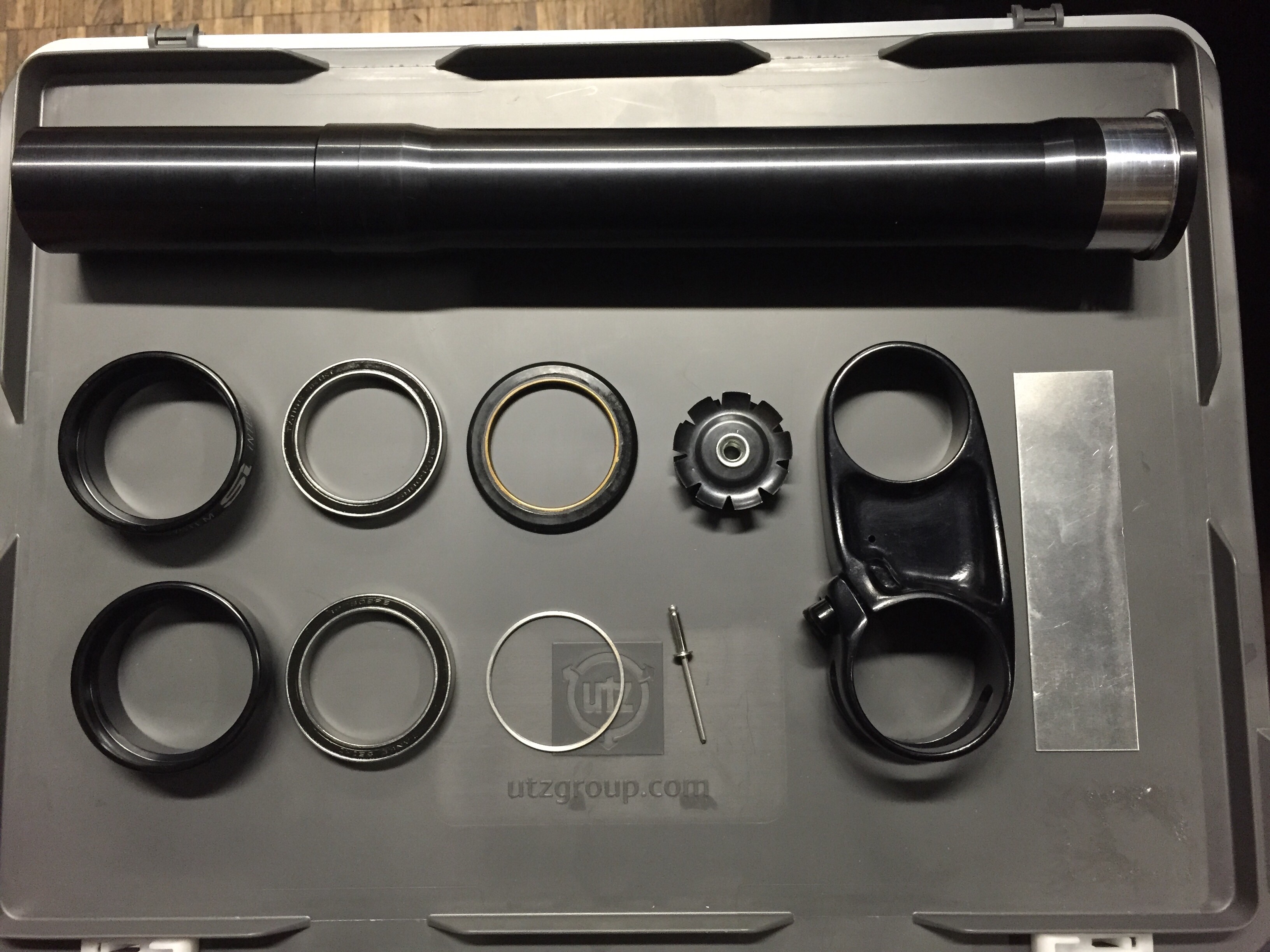

Hooligan Lefty conversion parts for Hybrid Lefty
Hooligan With Hybrid Lefty installed
Lefty 1.0 for Hooligan, crown height 420mm (Hooligan headset)
Lefty 1.0 for Hooligan Bridge distance 210mm for Hooligan headset.
Lefty 1.0 for Hooligan (modified)
Cannondale Hooligan Berserker, 2016 XT Brakes
Cannondale Hooligan Berserker, New Riser bar
2012 Hooligan Berserker mit 2014 XLR Carbon Hybrid Lefty
Hooligan Lefty conversion parts for Hybrid Lefty im Album Cannondale Hooligan 2012 (Lefty Project I)
Lefty for new style Hooligan 1.5 headset (2012-2017)
- Steerer Tube custom machined (340mm)
- Lefty/Headshock Headset
- Bearing Cover
- Star nut 1.5"
- Lower Lefty bridge, machined and anodized
- Lefty to upper tube Alu shim (30x116mm)
- Crown Race shim 1.56"
- Rivet 3.2mm
