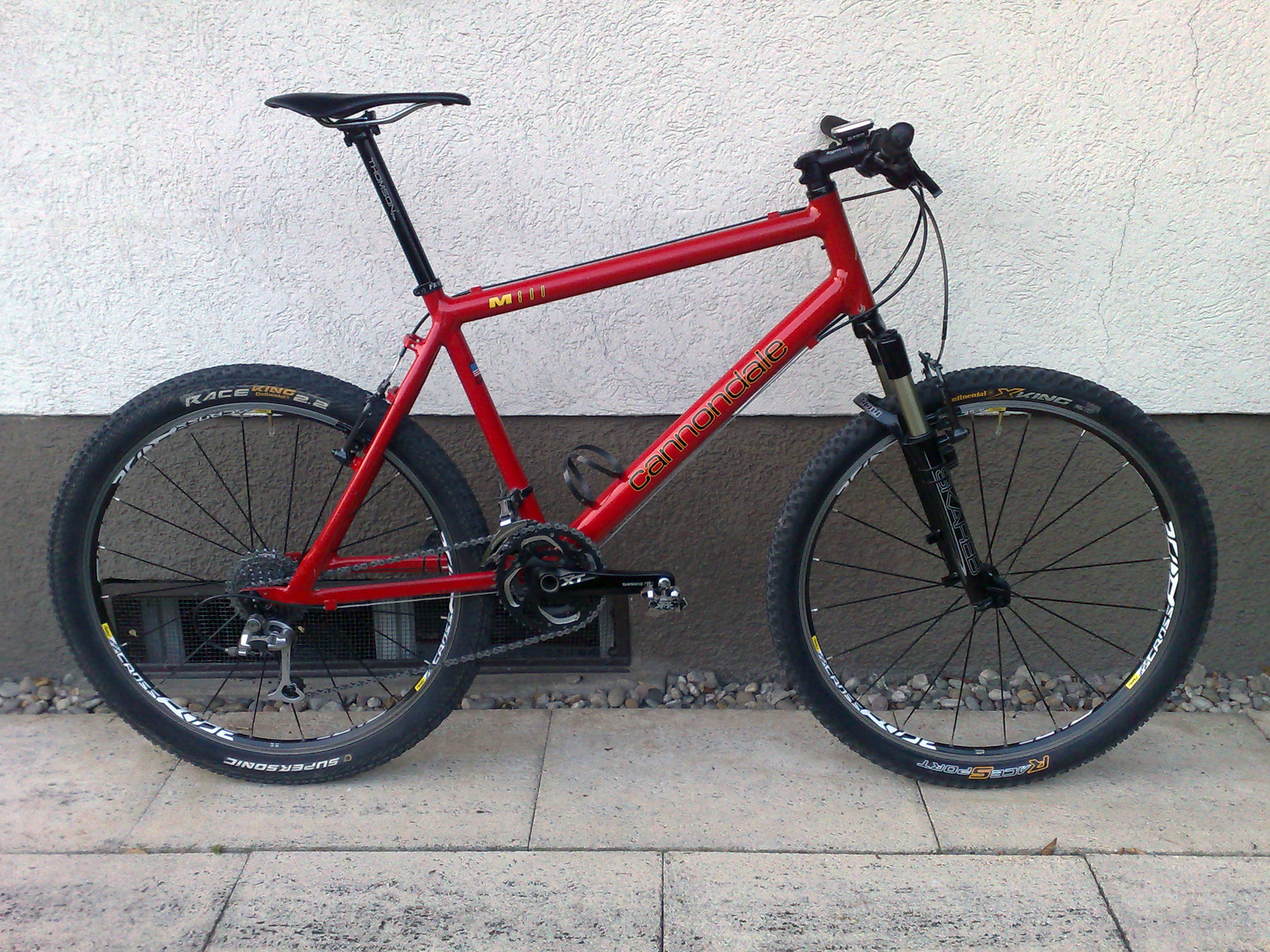

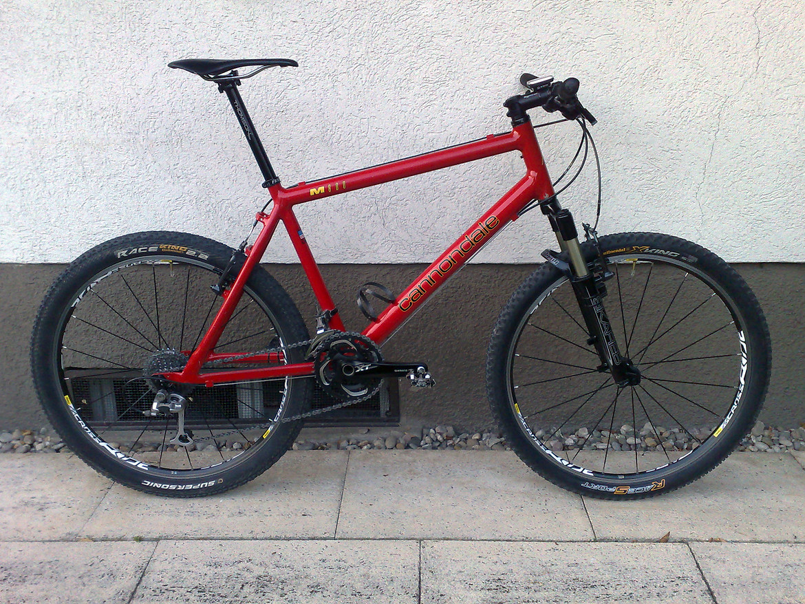

Saison 2016 // Update: Vorderreifen + 9-fach Kette
Gewicht: 9,97 kg
Teileliste:
▪ Cannondale M800 Beast of the East (20") ▪▪▪ 1590,0 g
▪ Manitou Skareb Elite (80mm) ▪▪▪ 1521,0 g
▪ Fun Works S-light Ahead ▪▪▪ 74,0 g
▪ Syntace Litecap ▪▪▪ 9,5 g
▪ Syntace F99 (90mm) ▪▪▪ 100,0 g
▪ Syntace Duraflite 7075 (25,4mm/630mm/8° ▪▪▪ 200,0 g
▪ Extralite HyperGrips ▪▪▪ 7,0 g
▪ FRM SC32 (31,8mm) ▪▪▪ 12,0 g
▪ Thomson Elite (27,2mm/330mm) ▪▪▪ 235,0 g
▪ Selle Italia SLR TT ▪▪▪ 146,0 g
▪ Mounty Special Lite-Axles OS ▪▪▪ 65,0 g
▪ Mavic Crossride UB ▪▪▪ 805,0 g
▪ Mavic Crossride UB ▪▪▪ 955,0 g
▪ Schwalbe High Pressure (15mm) ▪▪▪ 18,0 g
▪ Michelin C4 Aircomp Latex (47/57-559 SV) ▪▪▪ 135,0 g
▪ Michelin C4 Aircomp Latex (47/57-559 SV) ▪▪▪ 133,0 g
▪ Continental X-King 2.0 RaceSport ▪▪▪ 445,0 g
▪ Continental Race King 2.2 Supersonic ▪▪▪ 453,0 g
▪ Shimano SM-BB93 ▪▪▪ 70,0 g
▪ Shimano FC-M780 (170mm/24-32-42) ▪▪▪ 774,0 g
▪ Shimano CS-HG51-8 (11-32) ▪▪▪ 312,0 g
▪ Shimano CN-HG93 ▪▪▪ 273,0 g
▪ Shimano SL-M569 ▪▪▪ 251,0 g
▪ Shimano FD-M563 ▪▪▪ 125,0 g
▪ Shimano RD-M737 ▪▪▪ 240,0 g
▪ Shimano PD-M770 ▪▪▪ 350,0 g
▪ Jagwire Mountain Elite Sealed Shift Kit ▪▪▪ 70,0 g
▪ Jagwire Mountain Pro Brake Kit ▪▪▪ 61,0 g
▪ AEST CNC Brake Lever ▪▪▪ 67,0 g
▪ Avid Single Digit 7 ▪▪▪ 334,0 g
▪ Kool Stop V-Type black/salmon ▪▪▪ 20,0 g
▪ Tune Wasserträger ▪▪▪ 9,0 g
▪ Sigma Sport Rox 9.0 ▪▪▪ 80,5 g
▪ Zubehör ▪▪▪ 24,0 g
